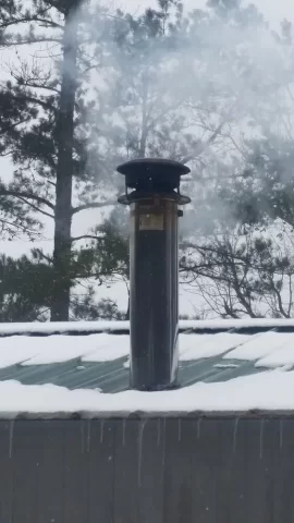

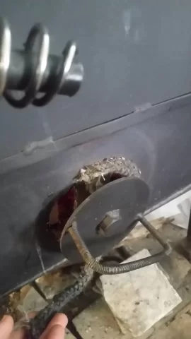

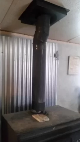

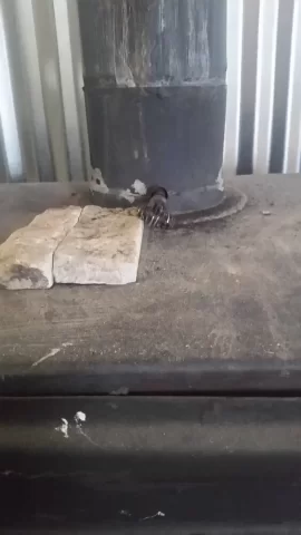

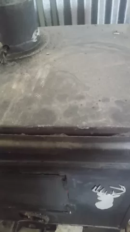

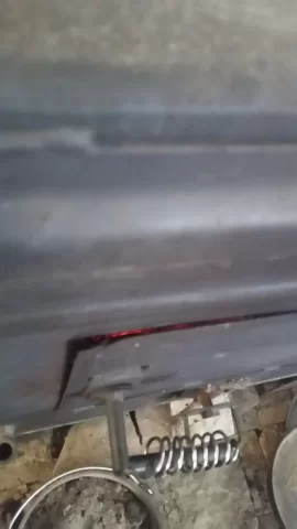

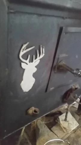

Here a few overdue pictures of our current setup, if it helps.

I didn’t expect perfection, but thought here would at least be some attempt at a flashing.
I wonder if the other penetrations have flashings.
I'll ask my husband. It was a friend of ours, who does construction for a living, who did the installation. I'm surprised he'd make a mistake like that.
Every pipe that pokes through your roof should have a separate boot or cone looking thing to keep water out. Sometimes silicone rubber looking stuff and sometimes metal. Goop alone is insufficient.
My husband says he hasn't been able to find flashings in the stores here that would work for our metal roof and prefab chimney; says it seems people here do it different from the way they did our metal roof in Texas a few years ago. So, it may take some effort, but we'll find the right parts and get it fixed. Thanks so much for the advice, guys! I really appreciate it!
If you know what brand chimney you have some members here could probably show you exactly what products you need.
I always use standard roof flashing that matches the brand of your chimney
Reactions: Pilgrim91
If the chimney pipe is 8" OD then Excel makes a good metal roof flashing.
This is a very short flue system. I suspect you will need to specifically buy a stove that will work on a 12 ft flue system and add another 2 ft. of chimney pipe to meet that requirement. If this brings the heighth of the chimney to 5' or more then a roof brace is required.
OK, thank you for the advice. We'll need to definitely increase our flue system. I've seen that the True North stoves require only 12 ft. min. But the Englanders require a min. 15 ft. That may be a factor considered in choosing between them.
I appreciate all the advice and suggestions, guys!! More than you know. Gives me some direction. Not sure yet the brand of chimney; that'll be a question for my husband, when he gets home from work. But, we should be able to figure out what kind of flashing we need. If not, we'll know who to ask!
Double check the Englander manual. It may state 15' from the floor vs 15' of total flue. There are some other manufacturers who specify flue height from floor.
