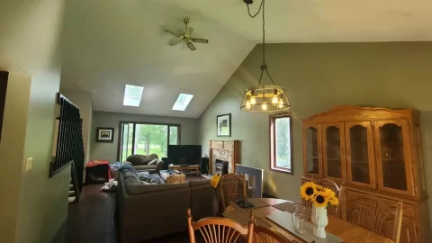

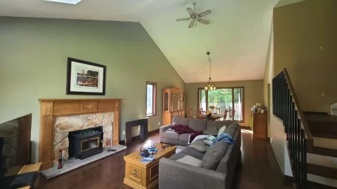

I have been lurking on this forum trying to learn and gather information while preparing to renovate our living room. Below I will attach pictures of the space and a floor plan which I hope will aid in delivering the advice being requested.

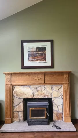

We have owned this house for just over 2 years (built 30 years ago) and would like to upgrade the insert while we renovate the living room. The existing insert surround has an osburn label on it and our primary complaint/concern is that the firebox is too small and the burn times are too short. We are constantly filling it up to the brim and the fire lasts about 4-6 hours MAX with the damper *almost* closed and it burning slowly. It also can only accommodate small pieces of firewood in the 14" range which we would like to increase.
After two winters in Ontario, Canada we have tried to use this stove as our primary heat source (oil furnace as backup) and unless we are feeding it every two hours the oil furnace is being utilized quite a bit. When the fire is constantly maintained the furnace is essentially un-utilized.

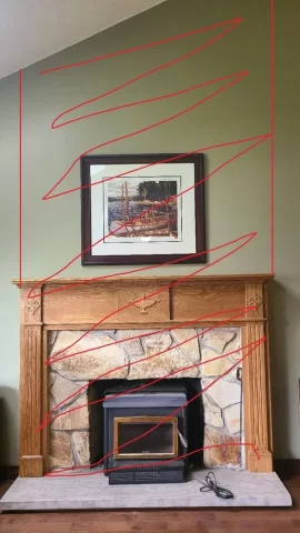

The fireplace it self has a brick firebox with soapstone and a soapstone hearth. We would like to remove the golden oak mantle and uprights and frame an extension on the existing soapstone to the ceiling and then re-clad the soapstone and framed extension in a new stone for aesthetic purposes.

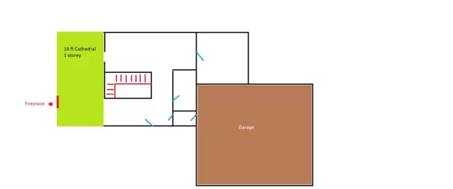

In the first floor floor plan below the red stairs in the centre are open concept and air floor to the second storey in not impeded. The cathedral room the fireplace resides in has a ceiling fan in the centre which also promotes airflow into the second storey quite well. (white areas on below floor plan have a second storey)
Pictures of the house, room, and fireplace:
20220919_142313.jpg 20220919_101604.jpg 20220919_142218.jpg 20220919_142232.jpg
We have been looking at the Lopi Large Flush WoodNexGen-Fyre as the most likely candidate for this project and would like to hear if this would be a good choice and or others that we should consider. The flue appears to have a 6" OD which was inspected and swept last year and reported to be in good condition.

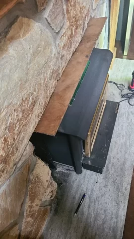

I made a cardboard template to test the fit of the Lopi and it would need to extend aproximately 3" beyond the existing soapstone:
As we would like to re-clad the soapstone with a more modern dark grey stone or a stone on board product are there any significant issues with taking this approach? I would frame the wall above the fireplace out to match the depth of the soapstone and the entire floor to ceiling would receive this new cladding to the continuous from floor to slopped ceiling. See red area:

2) Can I reclad the soapstone and frame the wall above the existing mantel with cement board and a non combustible stone on board product to provide the final aesthetic and depth required to fit the Lopi large or other larger stove if necessary? (existing golden oak mantel and uprights to be removed first)

2) Yes, as long as the insert clearances are met.

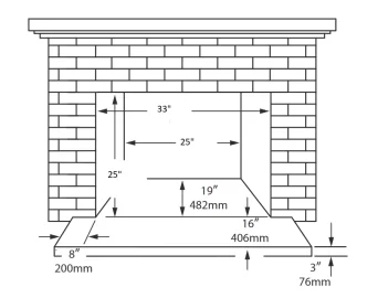

I looked at both of those stoves and I think my firebox space is a bit too small to accommodate. I have mocked up the below with my dimensions:
My main challenge is the taper from front to back on the sides. The firebox starts tapering from the front edge and the back is only 25" wide.

1)I don't think those stoves will fit without extending the firebox forward which may create issues with the liner lining up with the top of stove?
2)Thank you for that confirmation
3) Power outages are a concern and we made it through with the old stove. The oppostie end of the house has a propane insert which we use only for ambience or emergency heating.
So with all of that being said are there any other recommended inserts that accommodate what might be an aggresive taper from 33" at the front to 25" at the rear. The taper is straight, not stepped and the depth is 19"

What is the depth at the lintel level (top) of the firebox? Is the back straight up so that the depth is still 19" or is it less?
