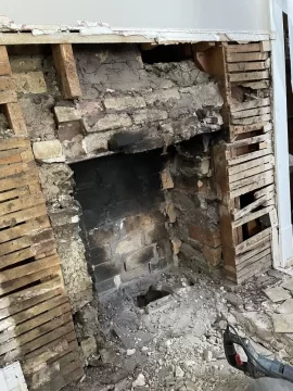

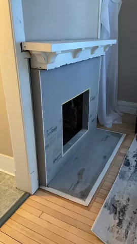

I ordered at Regency ci2700 and had a mason prep the space. When the installer arrived, they said it won’t meet code as it needs 2 layers of brick around the entire insert. Is this true? See pictures below. The one shows the exposed wood beside the opening before the front was redone.
[Hearth.com] Ci2700 wood insert clearance requirements [Hearth.com] Ci2700 wood insert clearance requirements
View attachment 292545 View attachment 292546
Yes it is absolutely true. And good job by your installer catching that.
