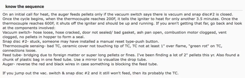

Found my problem. Everything checked out fine, but I found a post online that stated the sequence of events a classic bay uses to start up. I had not refilled the hopper with pellets, so that I could observe the auger to see if it was turning. This was a mistake - the hopper has to have enough pellets to cover the exit hole to create the vacuum that the stove needs to start the feed motor. Once I partially filled the hopper, everything started up perfectly. I have attached the file showing the sequence of events a Classic Bay uses.

I forgot to mention that the original problem was a small blockage in the vacuum hose right by the feed motor housing. I sucked it out and got a mouthful of sawdust.
