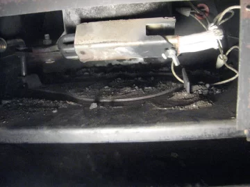

The ash plate on the bottom of the burn pot moves ok but the ash plate just below it, which empties the ash from the chamber ( directly below the ash pot and the one that contains the igniter), does not open and shut. The rod to the ash plates working ok and the mechanism works but the second plate does move. I got in touch with my dealer here in CT and then another Quadra Fire dealer in Minnesota, but all they have is a parts list and the parts that attach to the bottom slideplate shows nothing I also called the company and they route all incoming calls to the dealers. i have worked on it myself - replaced augur motor, igniter, thermostats and removed and tested the main control board so I can figure out more or less if I am given information from this site as long as the responder doesn't get carried away. I am after all, a woman and retired. I have to wait until the stove cools down and then vacuum out the ashpot. Getting tired of dragging out the shop vac. Well, upside is I don't put the vacuum away, just leave it off to the side If a potential thief broke in, it's likely to trip over the vacuum and break a leg. you can see the rod on the left and the igniter in the front, the offending plate on the bottom. I appreciate any help, Thank you so much in advance.

The rod goes into the bottom plate and is held there by a cotterpin pita but thats why it isn’t working the pin fell out or rusted away or the boltit pivots on is missing
THANK YOU!!! I thought it might be on the bottom of the pivot bolt, which is still attached. I had to replace a bolt that I found in the ash pan a couple of years back - I don't remember seeing a cotter pin. Is it a custom make for the stove part? Thanks again.
Cotter pin looks like its on yours but the pivot bolt is missing.
cotter pin. pita ( pain in the a*s). Relly hard to get back in

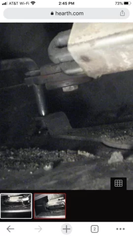

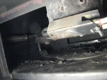

I believe the pivot bolt is there. I think it's the pivot bolt anyway. I googled it and the part came up under automotive and it looks the same. I'll feel in there to see if there is a hold in the bottom of it to take a cotter pin My other alternative i to go into the store and ask to see the mechanism so I can see for myself. I appreciate all your help.
If you look closely on the left side, you will see the rod goes through the pot floor plate then into the ash plate. The cotter pin is in that and it is good. Now if you follow thet bottom ash plate. Down over the bend you will see a hole that is where the pivot bolt goes, now that pivot bolt is a shoulder bolt. The sholder goes in the hole of the plate but not through the bottom into the ash pan.[Hearth.com] Classic bay 1200 free standing ash plate not working
If you look closely on the left side, you will see the rod goes through the pot floor plate then into the ash plate. The cotter pin is in that and it is good. Now if you follow thet bottom ash plate. Down over the bend you will see a hole that is where the pivot bolt goes, now that pivot bolt is a shoulder bolt. The sholder goes in the hole of the plate but not through the bottom into the ash pan.View attachment 271717
