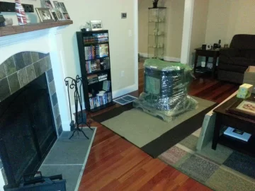

I will get some pictures posted tomorrow after the installers leave. Looking forward to it. Right now its sitting in my living room all wrapped up staring me in the face.
