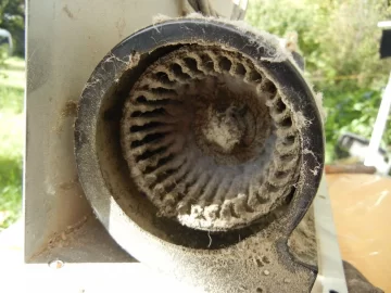

When was the last time the stove had the fans cleaned? There are some fans that are posted that have shown some major needing of a good cleaning.
  • [Hearth.com] Classic bay 1200 insert convection blowing problem
Picture was an extreme and not moving anything. It does not take much to really affect output. Wouldn't hurt to see if the motor can be oiled too.

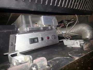

s there anyway just to replace a switch instead of changing the whole control box?
Looks to me like you should be able to replace the switch without replacing the control box based on the image below.

Do the pellets drop at a higher rate when the switch is on high versus medium? If it does, probably isn't the switch.
Well, CB 1200 insert has only one switch whereas a free stand form has two switches. Does Castile insert has only one switch, too?
Regarding pellet feeding rate question, yes, pellet drops a little bit more in high than medium. Does that mean that this switch adjust not only convection blowing but also feeding rate?
I did not know that.
Yes, with one switch, it does both at same time. Both Castiles have only one switch. My mistake on remembering which stove you had. kap
I am updating the result after thorough cleaning of convection blower fins and exhaust blower fins. I still do not see the difference though. I might have to contact dealer.
