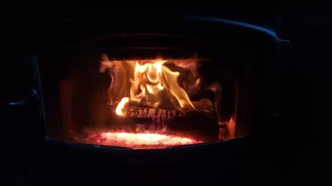

Thank you for all your help so far in my new wood burning journey. Second load of the day. 500 on the stove top dry wood. I get it were I think is good and then I check the chimney and theres smoke. So I open the air just a touch and it takes off to an inferno.
  • [Hearth.com] Clean burn help questions

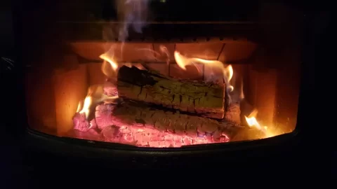

I gave it some air and it took off and theres no smoke now but I cant seem to find a happy medium

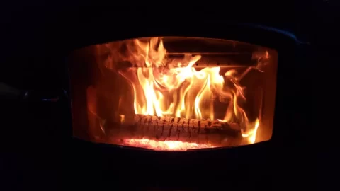

When you open it up the flames it the secondary tube then wrap around the baffle and the seem to allmost reach the flue opening

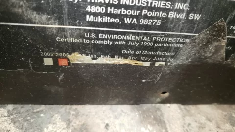

This all I could find on the back of the insert. Ut it was hard to read cramed in there upside down lol from what I get it complys with the 1990 standard and was build in 2006.

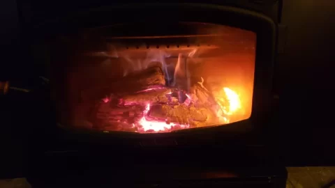

I still cant fund a sweet spot.lol if I get it turned down nice and check out side theres smoke. If I open it up I kinda have to baby sit so the temps don't get crazy

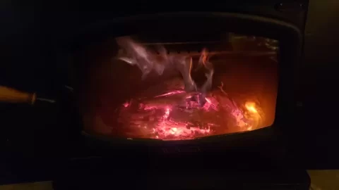

[Hearth.com] Clean burn help questions [Hearth.com] Clean burn help questions
Once I get it like this with good secondary burns. It smokes out of the chimney. If I open the air it turns into an inferno
Don't drive yourself crazy. You may be up against a limitation of the stove design with the single tube at the front. If you look at the slightly larger Lopi Answer you will see that there are 3 secondary tubes. The only thing I might change is to pack in more wood.
Ok so I shouldn't worry about the smoke so much? Thank.you
So far from what you have posted, you are doing ok. You are ahead of the game with having dry wood. When you do the first chimney cleaning you will get a better idea of how the stove is burning. Maybe clean it after burning a cord of wood.
