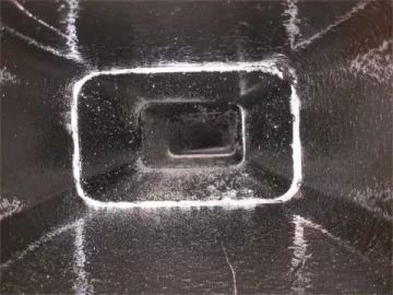

I have crapped up a lot of chimneys since then, just not the glass. To wit:
  • [Hearth.com] Clean Glass = Clean Stack?
What do you do with a glossy chimney like that? How do you start cleaning it?
Really Hot Fire With Lots Of Cardboard!!!
OK, you win - that is a messed up flue - looks like ice
I will remember not to use sarcasm with BrotherBart one of these days.
Actually it is the only chimney fire I ever started on purpose. To clean it out before installing the liner in 2006. It got glazed that way because my old insert had a popped weld in the top back hidden by the baffle letting cold air into the stream right as it exited the flue collar. Drove me nuts that season trying to figure out why the thing was smoking so bad out of the chimney and glazing the tiles. Attempts to seal the crack didn't work and I hauled it out back, bought the 30 and liner and lit off the chimney.
No I do not recommend anybody ever do it. But small unintentional chimney fires fires had been a fact of life occasionally in that flue for 21 years. It wasn't enough of a glaze to make much of a chimney fire and done with the stove out of the fireplace. Just a lot of smoke out the top. And the house is still here.
That chimney looks like you can skate on it!
My sig line here used to read "I learned everything I know about wood burning by screwing up." I have made every wood burning mistake you can make except the big one. I ain't burned the house down.
Yet.
How else do you learn? Before there were forums, there was trial and error.
Normally I like pretty shiny objects . . . but not this one. Great pic BB.
