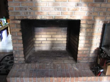

Finally, I fabricated a stop plate for the bottom of the chimney. This took a couple of hours since it was tricky shaping the trapezoidal size, but it came out pretty well I think. Here is a photo of the empty fireplace and the new stop plate:
[Hearth.com] Cleaned my chimney and removed my insert - Jotul F 600 coming!
I have a 13" x 13" top plate with 6" hole that I'll be placing over this 8" square hole once I have my T connector down the chimney. I plan to put insulation on top of this stop plate and then use high temperature silicone caulk to seal the smaller cap plate when I screw it in place.
Tomorrow I plan to spend some time seeing how clean I can get all those dirty bricks inside the fireplace. If I can't get them clean I'll probably paint the walls black. I'm hoping they clean up though.

I am looking to install a block-off plate myself.
Can I ask what gauge of metal you used, and how you attached it to the brick (sealed, etc?).
Looking forward to watching the project unfold.
I'm not sure of the gauge on the stop-off plate. I bought it about 25 years ago when I installed an Atalanta Stove Works Woodsman stove in my previous home. I used it under a layer of brick to make a hearth for the stove. More recently it has been sitting under my shop's wood stove. I pulled it out today to make the block-off. It's thick enough that I had to bend it three inches at a time with some large bending pliers. For the time being it is just held in place by friction, but when I do the final installation I'll drill some holes in the side flanges and put some screws in some mortar joints.
You can go light gauge here. It's easier to work with. 26ga is fine.
Yeah light gauge sheet will do fine. And tight enough friction fit will work. Well, it has for six years.
20 gallons of sote! !!! Why I used to pull that 650 pound slammer out every year to get that stuff out when sweeping.
Nice job,you are lucky to have a high lintel height makes installing a freestander a lot easier.You could try muriatic acid to clean the bricks, mixed with water.I would think twice about painting the alcove black, heat reflecting white may be a better bet
