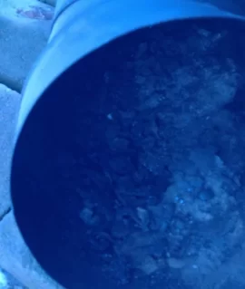

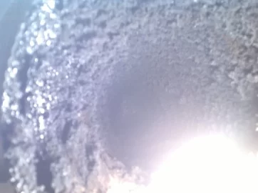

Thee years what a mess
[Hearth.com] Cleaned my stove pipe first in 3 years [Hearth.com] Cleaned my stove pipe first in 3 years [Hearth.com] Cleaned my stove pipe first in 3 years [Hearth.com] Cleaned my stove pipe first in 3 years [Hearth.com] Cleaned my stove pipe first in 3 years
jesus...
Wow thats some serious buildup. Now that you know how bad it was, how often are you going to clean now?

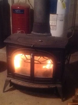

so what exactly is it that you burn, or should i ask what ;don't you burn? because surely you aren't burning seasoned wood!
Well we now have pictures of why to regularly inspect & clean the chimney & stove pipe.
I see soot & creosote.

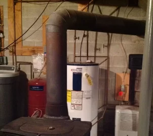

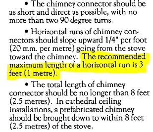

I can see a few things that could be contributing to the problem.
Big one is the long horizontal stove pipe. It acts as a choke to the exhaust draft & with all the connections you have a good chance of several leaks.
2nd is the amount of single wall pipe from stove to chimney, flue gasses cool down before getting to the chimney.

Never said there wouldn't be any creosote. Ive been burning 5-6 cord a year for the last 15 years and never seen 1/100th of that in the stove pipe. Once a year shouldn't bring 1/10' of what you have coming out of the stove. worst case scenerio would be less than 1/3 of what you have there over a three year period. Single wall pipe or not, either your wood isn't seasoned like it you think it is or you need to re-evaluate your air/draft situation. Are you choking it down all the time? something clearly isn't right. creosote should not be forming that heavily right out of the stove. Creosote forms from the flue gasses rapidly cooling. usually in a properly operating system you will have 90% of your creosote in the top 1/4 of the chimney because the gases have cooled so much by the time they get up that high. i'm glad you caught it before...honestly i can't believe you haven't had a cherry stove pipe yet from that creosote igniting.

You are correct, even the best wood will still leave some creosote in the chimney, but holy crap!
Those couple pics need to go up on a wall of shame somewhere!

What can you do to shorten that horizontal span?
It might even be worth the plumbing cost to move over the water heater and stuff to get that sucker closer to the wall.

That's what the stovepipe looked like on the stove in my house when I moved in. I probably got a gallon out of the the 8"x30" horizontal connector. I tapped on it and it make a "thud" instead of a high pitched "ping". Glad I didn't light it!!
As others have said, that long horizontal run isn't doing you any favors. I would consider ditching that 90 and putting in a couple 45's up to the wall (which will probably mean you have to move the stove too). Also, you really shouldn't have single wall pipe passing through any wall, combustible or not. The concrete making contact with the pipe is literally sucking all the heat out of your exhaust and causing the smoke to condense and form creosote....so if you really want to to it right you should get an approved thimble with the right kind of pipe to pass through the wall.
