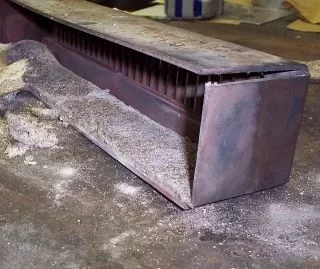

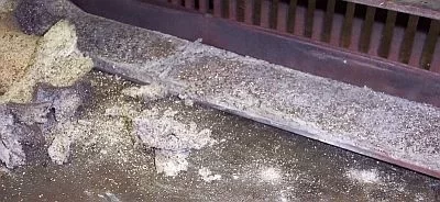

removed the 2 seperate honeycombs from the steel housing.
Where do I buy the packing, gasket stuff around them?
Ive seen a link posted for it before, seems like it was $8.50
I cant find the link.
I plan to soak in boiling water/vinegar, then rinse, replace surrounding gasket and reinstall.
WHAT is this gold dust that is in here?
GOLD!!!!!!!!!!!!!!!!!!!!!
im rich!
now I can pay for the stainless flu! or maybe even make a payment on a new cat combuster unit.

Those are expensive combustors take some of the gasketing out of the grove and try to measure it also measure the grove once you figure out what size, a lot of hardware stores like Ace Aubushon have gasketing also Home Crapo
the vinigar amd boiling water will probably do the trick compressed air and possibly pipe cleaners Looks like they have not been cleaned for quite some time I clean mine at the start of the seacon and mid season that's why I expect them to last over 5 years and I get top preformance from my stoves
