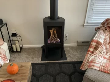

Hi there….have had my Jotul GF160 for 2 mos. now….its recommended early on after initial use to clean the glass of white glass film….Forgot till now so bought the Rutland brand cleaner…. The stove has the Proflame 2 remote as many stoves do…its been on CPI mode….To clean glass can I push the mode button to IPI so the pilot goes out….let the stove cool…. Then remove the glass - quickly clean then replace back on stove without turning the main gas valve off? Without unplugging the unit from the wall as well? The front glass comes off the stove but as it’s a 3 sided small glass window stove wondered if it’s good practice to try and clean the side glass panels too just by reaching over the logs and being careful? OR must I shut off the gas valve too Before anything at all?
