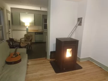

Knowing you like to see install photos I attach one.
Details
Primary heat 1580 sqft
Enviro Maxx (Vistaflame 170)
Ecobee 3 Lite
Tripp Lite surge protector
settings: on hi 2/lo 1; auger 4; combustion blower 4
