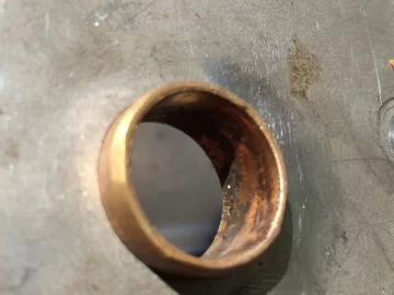

The manual also does not tell you how the brass bearing can get a gummy buildup, but when I look at the inside of many, I can see why the motors wear out so easily!
Check this pic out! They do not care about selling a $10 bearing, much rather sell a $200 motor right?

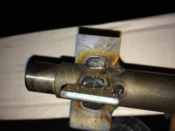

Anyway, On the Enviro, after getting the Auger motor off, the rest is easy. First bail out all the pellets to avoid the Avalanche when you remove the auger! LOL
Then just remove the 4 bolts holding the auger backing plate onto the hopper. Then cut around the edge of the backing plate with a knife if there is Silicone and then pry the plate off with a screw driver.
Pull out the auger, plate and bearing. The bearing is a press fit so you can pop it out. If the shape is good and no gouges, then a good cleaning and oiling maybe all it needs. I use a brass brush from Harbor freight for my drill/driver to clean it up nice and then some 3-1 oil to oil it up. Actually soaking it in the oil overnight is better. Then reassemble, but check for "Auger Pox" on your auger that shreds pellets! That is sharp bits of slag splattered when the spiral fins are welded to the shaft. I have found quite a few Enviro Augers, even a brand new one from Canada with Auger Pox! That is why some machines go thru motors and others do not! Get a grinding stone and grind down the POX and clean any black carbon off the auger with a wire brush on your drill driver and coat with "Dry Moly" spray. Then you will be burning HIGH and long last your auger motor!
See yellow arrows in pic below of my Brand Spanking New Enviro Auger with "Auger Pox"
