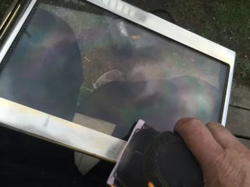

Pic 11 - Orig Auger polished with wire brush on drill driver to remove carbon. Pimples of slag(Auger Pox) ground down and auger coated with high temp "Dry Moly" spray!
Pic 12 - With orig auger motor and beating, After installing the new ignitor, the stove works. Pellet feeding is choppy and the old tired paint is faded and gold door looks worn!
NO MORE Fire YoYo ! ! ! LOL

The results are in and the pellet feeding is much more consistant. Not choppy like with the old gummed up brass bearing.
Also to get the value in, I had to sand the gold on the fire door out! LOL
