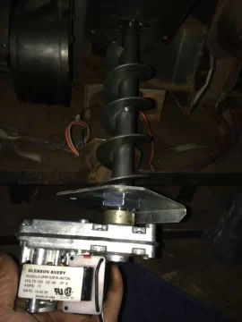

New auger, new Bushing plate with Nylatron bushing and rubber gasket to replace the old brass bearing and metal gasket. Also a new Gleason-Avery high quality and highperformance auger motor!

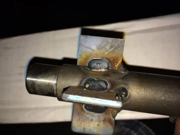

The Brand New Enviro Auger is LOADED with the dreaded "Auger Pox" Oh No! No fears, we have the cure!
See pics below!

Now the new auger and bushing "Turns like Butter" LOL
Pic 1 - New Enviro Auger for stoves built before 01/08
Pic 2 - Auger Pox - bad case - needs grinding and wire brushing!
Pic 3 - New Auger treated with "Dry Moly", Nylatron Auger Bushing, New EndPlate and New rubber gasket
Pic 4 - New upgraded setup installed to "Pimp your Ride"

nice going, Don. thanks for the pics and info.
what exactly is Auger Pox (corrosion of some type)?
Reactions: Don2222
When the spiral fins are welded to the shaft bits of slag splatter and form pimples that are very sharp and shred the pellets passing through! No brand of stove is immune. These pimples must be ground down so check your auger and the flight tube also!
Spiral fins are called "flighting"
