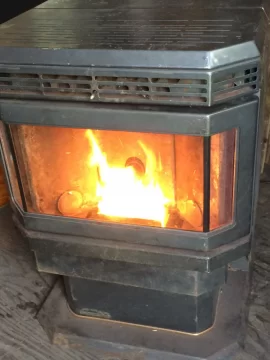

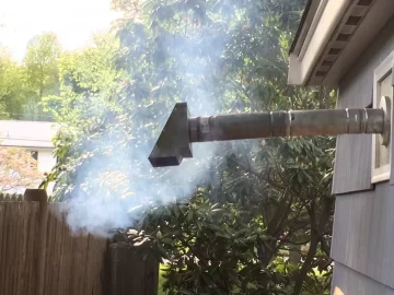

Pic 1 - Intial Smoke from residdual black creasote inside exhaust chamber
Pic 2 - Stove is cranking like nver before!
