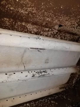

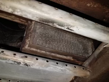

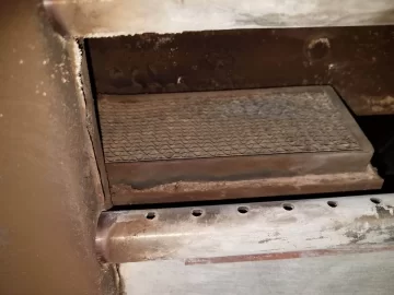

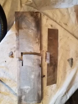

Turns out bffle was completely cracked. Cats were definetly ash covered. Attaching photos of baffle before removal, broken baffle, right cat after vacuming, left cat after vacuming. Three questions:
can I reinstall this baffle or should I replace?.
Do the cats look "clean" enough?
Does it appear I am missing gasket around the right cat in the lower right and does that need fixed? ok, that was 4 questions

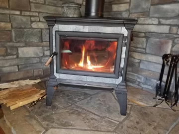

what the hell... checked with stove company to see if I could pick up baffle that they ' supposedly' ordered 6 weeks ago. They never ordered it.🥺 It is 15 degrees here with a "zero" wind chill. I reinstalled broken baffle, fired up stove hoping I cleaned cats well enough to get back to some semblance of normal operation for this stove. Seems to be operating "fine" ... for now.. lol.
