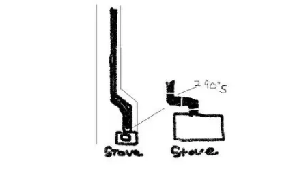

My concern is that I have two 90's at the end of my liner by my stove. The attached pic will give you a better idea. (sorry for the microsoft paint drawing) I have a Lopi 1750i and am able to move the fire brick to get to the bypass opening. Am I able to clean those 90's from the bottom? I don't think moving he stove is an option unless I have the installers come back and move the stove out and repair the pipe after cleaning. Do they make a brush to clean the 90's from the bottom?

I've heard that SS liners should be cleaned with a poly brush, rather than metal wire. I'm guessing you'll have to remove the stove pipe to at least partly clean bottom up, but I'm no expert at sweeping - going to do my first sweep before next season. Cheers!
