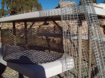

Thanks, I'll do the overn cleaner theng, but fires the mesh. you can see here in the pic the original mesh- the dark one and had some clog patches on it. The new roll of 1/2" square mesh that I have left over from another project is what I'm gonna put on now, heck- I might even cut a few links out here and there to open it up a bit more.....................

I use carburetor cleaner to clean off the brown stains. I really like a shiny SS chimney cap through the summer so I hit it with all my chemicals. I even tried diesel fuel but it wasn't as good as the cheapy carb cleaner from wallys. No sense in cleaning it now though since it will stain again with the fires. Only thing to do now is keep the screen clear and maybe windex the outside of the class A. Make sure no creosote or other funk is getting above the flashing where your roofing meets up above the chimney.

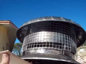

Makes sense- no point in making it sparkle now just heading into burning season. I'll hold off 'till summer to get anal. Thanks for all the suggestions, and that chicken fence/ wire sounds like the perect thing, Bill but all I had on hand was this 1/2" mesh, but I went ahead and cut a few bigger, can't wait to get this back up and run a fire................
