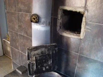

I can't find the right material to cement the cleanout door into the opening. Iv'e tried concrete and mortar but it keeps drying out and falling off.
Should I use grout ? stucco ? construction adhesive ?
This is aggravating and the season is about to start so I've gotta get this right.
p.s. I am going to replace that galvanized stove pipe with real "black pipe" this week.
Meanwhile - What do I do about this cleanout door falling out? (see picture)

I'm not so sure on this one. Furnace cement maybe?
Sounds to me like you need a mechanical connection. Screw? Tapcon? Anchor into block? Some kind of clamp? What you're doing obviously isn't working.
Can you get some tapcons or molyanchors set around the opening, then drill mating holes and screw it in place? If yes, maybe also epoxy the frame with the screws as anchors.
yes, that's doable.
seems mechanical fastener is the only way to go

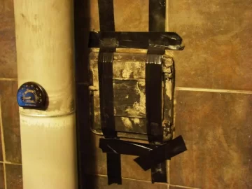

and here's the fix ... fresh stucco and some tap cons embedding into the under mortar
OK, its actually just duct tape LOL ;=)
