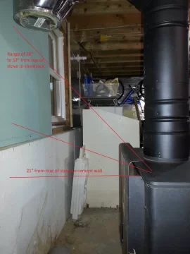

I have asked this question before but as part of another post and I think it got buried. I am installing a quadra-fire 4300 in my basement attaching to metalbest stovepipe. The allowable clearance from the top to combustibles is 53 inches. The allowed clearance from the rear to combustibles is 11 inches with single wall pipe. I am concerned that even with these clearances the distance from the top of the stove to wall is less than the 53". Am I being overly cautious when I think I should shield the back wall too? Is the 53 inch measurement really meant to be taken at a 90 degree angle to the stove top? [Hearth.com] Clearance to Combustibles

The 53 inches is straight up above the stove. I think this is because the heat radiates mostly straight up off the plate steel top. The diagonal you are measuring is not a concern.

Thanks. I felt it had to be okay but better safe than sorry. Is that a quadra-fire in your profile pic?
