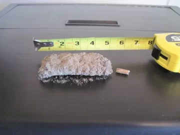

A real clinker.
[Hearth.com] Clinkers?
I make one or the Bixby does every 15 hours on low.:)[Hearth.com] Clinkers?

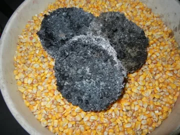

Is this show us your clinker day? or show us your hockey pucks?
Reactions: SmokeyTheBear
What can I say, I'm from the state of hockey and ten thousand taxes and rising, both burn my ash.

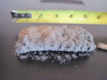

Here one that my stove birthed from some so-so pellets:

How do you keep it from getting stuck to the metal? I use NEWP/ GS ash is OK cake is not that bad and glass is clear for a few days. But the wall of the pot is a mess and I can't get it all off.
The clinkers I get don't get stuck on the metal. The black carbon build up does and I scrape it off with a big screw driver.
