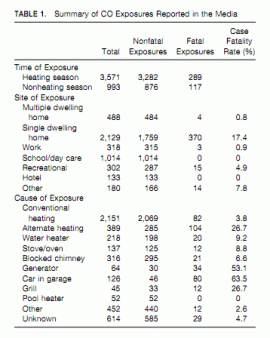

Thanks for the valuable input, Jake!
Now that I know that statistical information about wood stove involvement in CO exposure is not already on everyone's table, I Googled a bit and found the following interesting tables in a (broken link removed to http://www.nchh.org/Portals/0/Contents/Article0267.pdf) The authors of this article used news-feed clips to collect 3,571 cases of CO exposure, with a total of 289 human fatalities.
Exposures involving faulty heating systems appear to constitute the majority of all causes. Unsurprisingly, about 60% of all exposures occurred at home although school/day care exposures also constituted a surprising 28% (without fatalities, fortunately). About 25 % of the survivors credited CO detectors with saving their lives.
Wood-burning fireplaces and stoves were not specifically singled out but 318 cases of "blocked chimney" exposures (with 21 fatalities) suggest to me that they must play a fairly important role in the overall picture.
The demographic distribution is also interesting, with the highest fatality rates in New Orleans, Detroit, Atlanta and Dallas. To my surprise, 2 big California cities (Los Angeles and ,to a lesser extent, San Jose), were not very far behind.
At any rate, everyone can study these tables and draw their own conclusions.
Henk

Good stuff . . . but the issue on the blocked chimney . . . doesn't necessarily have to be creosote from a wood burning appliance . . . could be due to animals nesting or blocking the chimney, chimney degradation or even in the case of my old oil boiler -- even though I cleaned it twice a year it would gunk up with enough oil soot to block the chimney . . . I finally gave up on the old system after losing heat one too many times and growing tired of shop vaccing the messy soot from the oil boiler every few months . . . and replaced it with a new oil boiler which has been very reliable.
Good points, Jake
Let's hope someone can find CO exposure statistics that are more directly related to wood burning than these.
Since it only took me a couple of minutes to find these tables, I have a hunch that something better is likely to be out there.
Henk
