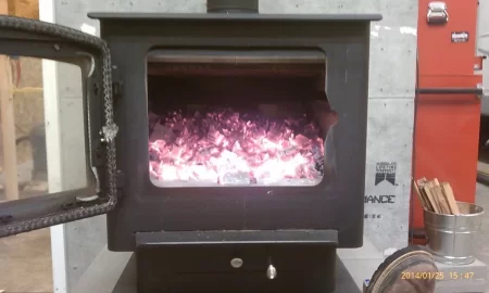

Here is bone dry wood in my shop stove when it is being asked to make more heat than it is capable of.
I love it when the coals are salmon pink like that with no ash stuck to them. The ones I dislike are the bright orange coals in a bed of grey ash. The orange ones cloak themselves in ash and burn slower and slower and slower.
The salmon pink ones like you got pictured, at least at my house, are burning hot and will keep burning hot until they burn away.
Too bad I am seeing orange instead of pink in my stove this year, but I am in the game and looking forward to next year already.
Thanks for the visual Highbeam. This could also be a factor, my home is also very drafty so I'm sure none of these traits are helping me keep the home warm. If I am understanding correctly the process of accumulating this many coals is from constantly reloading the stove to keep the stove hot enough to generate then heat that's needed to warm the area, because the heat generated from the coals is not sufficient to do the job.
