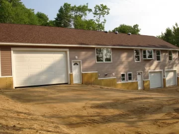

Here's the house. The main floor is 1400.
[Hearth.com] Code Question ~ HRV
The foundation has 4" of foam too. I live in a cooler.
The factory was doing a 2x10 house for someone in Canada when I was there.
