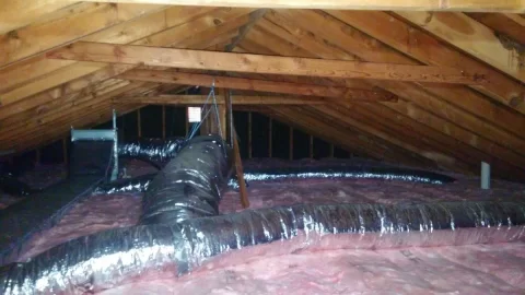

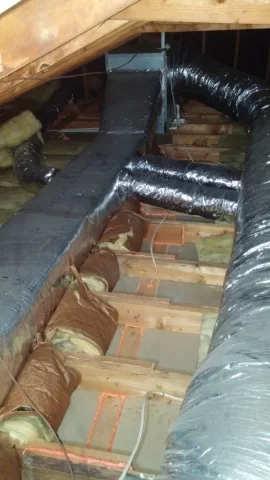

View attachment 187482 View attachment 187483

Generally R2 some good stuff R6. Thats in perfect condition, with a perfect install.

A buddy of mine just built an energy efficient house and his hvac guy said the ac ducts should be the same temp as house. Hes also getting moisture dripping from them.
Theres no way im keeping mine warm, theres just too much of it in the attic and not insulated enough. I taped paper to my 1st floor vents, last year i stuffed towels in them! These are the only vents i still feel a cold draft and thats even with the return covered.
