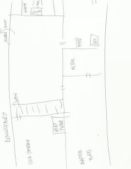

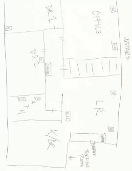

OK, here are some freehand drawings that aren't to scale, along with rough approximations of the locations of vents. I think the vents blow instead of drain, with the exception of the one in the hallway, I think it drains. I'll have to experiment a little with a lighter to see whether some of them blow or drain... but I think all of them blow with the exception of the one in the hallway.
The thermostat is in the Cold Storage room. If I could possibly align the stars to keep that room cold I would LOVE to do that. It's a great space to store my pressure-canned food.
The bottom floor is a daylight basement with the exception of the cold storage room and the back of the master bedroom, that is all completely underground and likes to be at 58F. There are open holes between the closet at the back of the master bedroom and one upstairs bedroom, so heat going from the den through the master bedroom would flow to that upstairs bedroom unimpeded. Or cold air flowing back down. I don't know which one is the case, and it probably depends on the relative heat in each room.
The upstairs bedrooms are much cooler than the rest of the house in the winter, and much warmer in the summer. If I could connect them to the rest of the house then they would be more regulated.
If I could do so safely, I could add a cold air drain from each of the upstairs bedrooms that goes directly to the master bedroom, and just leave the master bedroom door open when the stove is cooking. More cold air going to the master bedroom, more warm air convecting up to the upstairs bedrooms, and the stove could cook off at high temperature with lots of air flow and space to dissipate the heat. That would keep the whole house toasty and comfortable. If I can put in fans that assist the cold air drains, that's all the better.
But I don't know about that stuff, I hope you guys do. The box fan tipped down on a folding chair in the hallway thing is not something that's going to work out well in this house. The hallway is too narrow.
