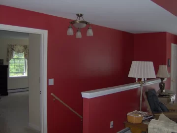

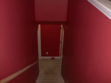

    Upper portion and lower portion of my supper "sectrit" no duct ducting

    Yep, it is currently 72.6 in my den, 68.8 upstairs in the great room, and just for giggles 66 in the master bedroom. Which is the room at the head of the stairs on the left above the den.
    But you see that is fine, the stove was purchased to heat my den, the fact it can handle the house is just gravy for the mashed spuds.

    My point is that there is a large opening between floors where the stairs go up. So what difference would it make if there were registers cut into the floor to let heat through? Its not like the floor is rated as a fire break.

    That is something to take up with the code folks, actually in newer construction it is likely that what is between floors does qualify as a fire break. In some buildings stairwells must be doored off with automatic door closers. But we don't want to go there.
