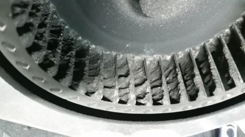

I'm not sure if I have a problem with my stove or if regular cleaning of the combustion fan is needed. I cleaned the fan and I've used about 10 bags of premium hardwood pellets and it needs to be cleaned already. I'm wondering if the fan is not running at full speed.
Looking for some direction .

Regular cleaning is normal. I would look at your fuel and fire. Thats a lot of deposits for 10 bags.
I clean mine about once a ton. I agree, looks like a lot for 10 bags.
I found with mine, I will have to clean the pipe (and blower) considerably more often if I have the blower running too high. Rather than more of the ash staying in the firebox, it ends up in the chimney. Also a ridiculous amount of clinker in the burnpot.
My experience FWIW anyway. My blower doesn't even have the same wheel type.

Ah...okay. That makes sense. I was thinking I needed more air. When I first started using it I got very modest amount of clinkers and now I'm getting a lot.
If your stove was starved for air, you'd see a LOT more soot in the fly ash.
Reactions: Yuneec Pilot
You want your flame to be busy and bright yellow/orange. If it slow and the flame is dark orange and black give it more air.
