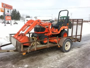

The 2005 BX2200 with 950 hours was $8500 including tax with a 60" mower and loader. Used was the only way to go for me.
