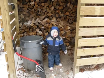

I know this issue has been argued/debated to death, but I'm just going to toss in my experience, and others can do what they want with it.
Three years ago, I split and stacked several piles of black locust, pin oak, and poplar. They had each come from the same trees, and had been split/stacked at the same time. Some of each I put in my outdoor racks near the house, in full sun and wind, the rest I stacked inside an old stable on my property, which never sees the sun inside, and has only tiny windows for cross-vent. My plan was to move this indoor wood to the outdoor racks later, for additional seasoning, and to have it closer to the house for winters down the road. I move the outdoor wood into an unused corner of my garage several months before I plan to burn it, so it has time for rainwater etc to dry.
Fast forward to the present. I have been burning, for the past 12-18 months, only the outdoor wood, with pretty good results, even in my finicky stove. But as I used up this most recent rack, I decided I needed to make more room in the old stable by burning some of that same wood. I wasn't sure if it would burn well, since it's been much more protected from sun/air.
Surprise, it burns much better. So good that I've had trouble keeping the stove under control with the primary air fully closed. Again, it's exactly the same wood in all ways, except that it was always covered.
I know many people here leave their wood outdoors right up till they burn it, and seem to do fine. But I inadvertently did a controlled experiment, and based on what I've seen, wood that is always covered burns much better than wood that was ever left exposed.
From now on, i'm keeping the stable full, and the outdoor racks will only be for overflow.
Just tossin' it out there...

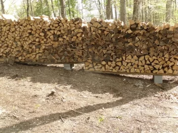

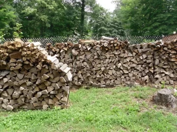

I cover up right after the split and two row stack. I use a gable roof frame that creates 1 ft air space above the stack and the tarps. Besides a huge increase in the life of the tarp it keeps the wood dry dry dry for years before I burn it. I can't say I ever did a comparison, but non of the seasoned uncovered stacks of shoulder wood around the yard come close to burning like my main covered wood stacks.

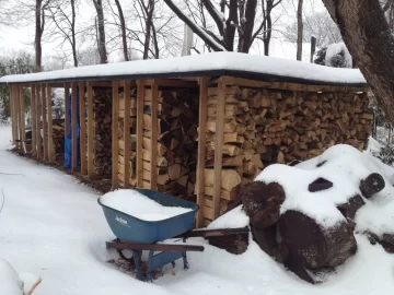

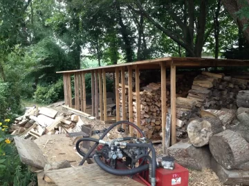

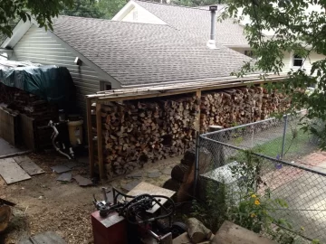

I split mine and stack them in these covered racks that are 10' long , 2' wide and 6'-6" tall
It keeps all the leaves out which in my opinion get into the piles then get wet and then start to decay and clog it all up and then the air can't move through as nicely.
[Hearth.com] Comparing covered vs uncovered wood
Two racks are 6" apart and then there is a 30" separation and then another 2 racks.
I just walk a wheel barrel in like I'm in the supermarket isle.
Now all this was top covered with a tarp right after I finished stacking it. Start to finish was about 3 months. March to May and then it was covered.

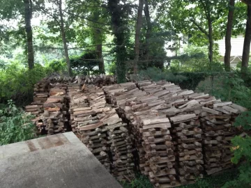

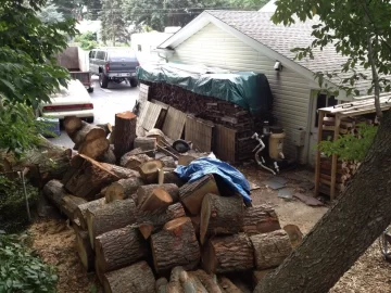

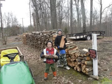

That is a yearly discussion here- some top cover as soon as c/s/s some do it later on, or never - I personally do not - and will not argue with those that do.
Not saying that it is a bad thing to cover, just that when someone comes to my place the first thing they see is all the stacked wood, and I think it looks good not covered.[Hearth.com] Comparing covered vs uncovered wood[Hearth.com] Comparing covered vs uncovered wood[Hearth.com] Comparing covered vs uncovered wood

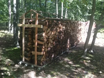

This why I'm glad I top cover.
