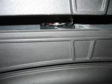

I have a question about where to take the temp. I am seeing he highest temps off the flue 500-600+ But others seem to have a magnetic thermometer in the front of the air channel. I also know that there is a fair bit of measurement error for magnetic and IR thermometers. If I shoot the inside of the fire brick in the stove it is well in excess of the 500 constantly.
Where does one properly take the temp measurement, with IR and with magnetic thermometer?
Here's where I have a new Condar magnetic thermometer. I saw the location recommendation in another thread. It's reading 600 °F. I was using a Rutland thermometer but it started 'sticking' after a few short months. I also have a Fluke 62 IR and measure the flue pipe exiting the stove on top. One thing I've noticed with the Fluke is that if it is aimed close to a strong heat source, it will subsequently read higher than the actual value until it cools down. So it's basically a one or two shot deal. Hence the magnetic unit.
