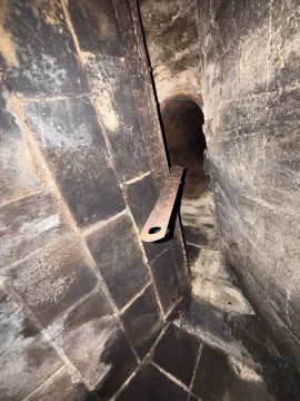

Hello,
We recently bought a new home and I was excited about the masonry fireplace. I believe it was built in the 1970's in Agoura Hills, CA. We have had several chimney inspectors come out and the issue seems to be that the clay flue tiles are incredibly misaligned. I am wondering why there are so many different pieces and not one long continuous clay flue lining. They don't appear cracked, just separated and misaligned at the seams.
What are my options for repair? I don't want to demolish the whole thing due to the exorbitant cost and expense. Plus, I would need a special permit to rebuild and I don't think you are even allowed to rebuild a brick chimney in CA anymore! I really want to preserve what is there. Do we have any options?
Thanks so much!

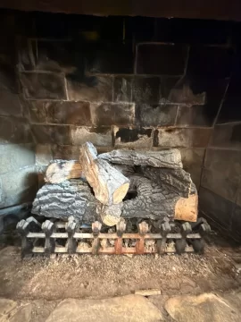

What is at the bottom of that chimney? What are you looking for as a burning experience? Open fireplace, insert? Wood burning or gas?

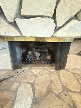

Attaching photos of the bottom of the chimney. We want to burn gas for now but would be nice to have the option for wood in the future. It is currently set-up for gas burning and the gas line works. Ty!!

You might want to convert from open wood burning, to something that uses a liner. Depends on what you are planning.
Even then, the flue tiles evidently are not fixed in place. (they seem to be stacked in a much larger brick chimney without something on their outside to keep them from moving.
If one could add a liner, and the tiles move afterwards, the liner might get damaged.
I think the only way is to do a proper rebuild.
Or simply use class A chimney pipe. It's better overall in function.
Then again, I'm not a chimney expert...

The issue with wood as is would be creosote forming behind the clay tiles. There’d be no way to clean it. It could ignite and chimney fires are, well, bad for homes.
There isn’t any worry of creosote with gas. We don’t know what the condition of the rest of the chimney is though.
Reactions: Whitenuckler
It is normal to have the clay be in 2 ft sections. One continuous liner would not be feasible for construction.
I would think the oval clay liner you have would probably restrict a new insulated stainless liner from sliding in there. For a company to break out the current clay and transform into a safe wood burning fireplace, that should be less than the 35k quoted. Not sure what prices are like where you are but here in southern CT (not cheap but not horrible), I would think a company could do this for maybe half that. Perhaps a fair bit less depending on exactly what you have there to work with.
It’s tough to know from the pics are there are actually gaps in your clay liner, but I agree that smoke getting behind the liner could be an issue with creosote forming, which could be a risk.
Yes, chimneys in older homes did not have clay liner, just the outer brick. However, there were a lot of chimney fires back then too. Things in the past weren’t always built better.

It looks like you have an open hearth wood fireplace, and then a gas log conversion. If the chimney is not OK for gas, then you would then need to do a conversion. You could have a gas fireplace with a new liner. You would need to check out more fireplace stores, but make sure you get referrals and as many people in as you can to quote.

Those clay tiles will need to be removed for pretty much any option to make that fireplace functional. The only option that wouldn't require it would be a gas insert. And pretty much anything other than a gas insert will probably push over 10k.
Thank you! What is a gas insert?
A glass front gas stove that goes inside a fireplace with 2 small liners running through the chimney. One intake and one exhaust
I guess you understand you can't burn wood with that gas pipe in the firebox. I'd guess that since you had an inspection and they said it was no good I'd think insurance would not cover if you had a problem with a fire.
What is your end goal, do you want real heat or just ambiance?
I'm with Bholler, the best choice would be a direct vent gas insert. Depending on your fireplace size opening, that will determine size of insert to install. Gas line is in place, and 2 3" liners would go up the chimney and top plate/cap would go up top. Then you have a direct vent (pulls combustion air from outside), true gas heater. You choose the interior liner, the face/front and the surround closes off the fireplace opening. Seems to be a good choice. Inserts to cost somewhere typically 7-10K total. Lots of good choices too. Hope this helps.
I believe an insulated liner can be run in the brick only, i.e. without the ceramic flue tiles?
If that is correct (@bholler), then busting out the ceramic flue with a chain, not messing with the brick chimney itself, and running an insulated liner, may be a reasonable way (cost) to get this up to wood fire standards?
This is correct, this is often the only way to get a chimney to work properly and be safe. I had that done with my masonry chimney a while back. Old clay liner was broken out, and then an insulated heavywall liner was installed to my wood insert.

Well yes and no. Clay tiles done right with proper clearances can be perfectly safe and meet code. But in reality the clearances are never there. And in this case the tiles were never laid correctly. So yes insulated liner is probably the only way in this case to meet code for wood or a gas log set. But it is not going to be cheap at all

My question was whether clay tiles (i.e. a functioning chimney) are needed to run an insulated liner in (just like a functioning fireplace is needed for an insert). My thought was no, clay tiles are not needed, and that indeed seems to be the case. I.e. you can run the insulated liner in the brick outer chimney only as visible in the pic. (?).
I.e. bust out the tiles (should be relatively easy if there's air behind them and they're loose) and run a liner.
Maybe not cheap, but likely the cheapest option to get this chimney wood fire safe imo.

No clay is absolutely not needed with an insulated liner
