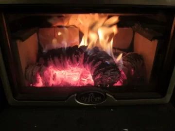

Here you see why I only use a half Presto Log at a time;
[Hearth.com] Compressed logs.
They expand!
So, I get the fire going with paper and kindling and then a couple of splits then when a nice coal bed happens I start with the Pres-To-logs a half log at a time.

Yes, that is a symptom of a lower compression vs the very dense extruded logs. They also leave more ash.
