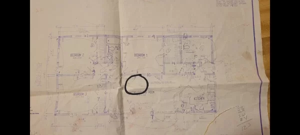

Thanks for your response. Sorry, my long post may have gotten confusing. It will be in the living room area. Attached is the floor plan with stove location circled.
Great. That's a good location. The Super will do the job. It can burn a small load cleanly and will provide good burn times when loaded full. The Quad Millenium is also a good workhorse.
You may feel more comfortable sitting close with the cast iron cladding on the super, the T5.
