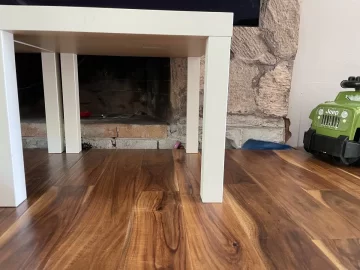

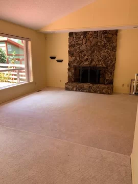

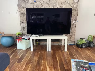

Here's the original and what it's like now. This is what is looks like now sorry there's a tv in the way. About 5-6" below the current floor is the old subfloor. When we did the demo there was a gap of of about 6" in front of the fireplace opening that was outlined in masonry (cement block?) and the old extension must have been built out from that.

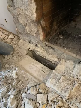

I just found a picture from when we demoed the old extension
[Hearth.com] Concrete Hearth Extension
