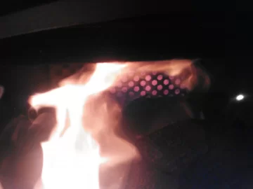

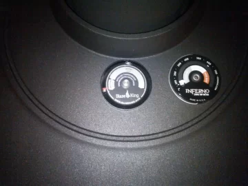

I rarely use the catalysis thermometer to determine when to close the bypass. It is to slow to react. The two pictures were take on a cold start. The stove top first then the combustor as fast as I could. If the combustor is glowing it is active. The fast way to get the combustor active is to start the fire so you have flames bouncing off the flame shield.
Damn, that's kinda amazing. I have to say though, I think you are experiencing EXACTLY the effect I'm describing. That is, I believe that if you had the version of the thermometer with actual degree readings on the scale, and if the stove was cold, it'd be reading about MINUS 200 degrees (if the scale went down that far). So it's really showing 500 degrees or more in the photo. I might be wrong, but next time the stove is cold, see if the needle is not well below the bottom of the "Inactive" zone (not at the bottom, as I believe it's supposed to be).
Sure, but is the other thing the case: if the converter is active, must it be glowing ? And I'm pretty certain that's not the case.
