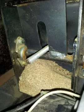

Well. This is something I apparently have never cleaned before! Took me forever to get to it! I'm not sure that this was causing all my problems, but I imagine it certainly wasn't helping things!
Eventually it would cause problems.
Now you know why we harp on cleaning, and more cleaning, and even more cleaning.
Dust may protect the furniture but any of it, ash, or other stuff inside a pellet eater is not gonna help at all.
My stove doesn't have a place for fines to collect. How do the fines get in these places? Through the auger bearing, or what?
Different feed system, this is actually a good thing provided you know about it and the need to clean it, but you know that is in the manual (that paper thingy with pages of words, that no one seems to ever read).
I would not feel right about the stove untill I pulled the auger and inspected the tube right up into the hopper for evidence of a gummy buildup .It`s really a simple procedure.
I just picked up a used Accentra from 2006. What is this a picture of? I want to make sure mine is not full of this! :eek:
Does anyone know? ;?
It's from the feeder chamber. Like I mentioned it took awhile for me to get to it. It's not as simple as it looks on pg 23 of this online manual: (broken link removed to http://hearthnhome.com/downloads/installManuals/Accentra.pdf) .
I've owned the stove for 2.5 yrs now and hadn't cleaned it out. Glad I found it, but seems like it will still work for awhile even if you don't get to it all the time!
(Oh, and I think this stove is from 2005)
