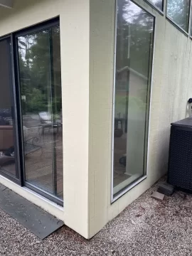

Hi everyone. First post here but I've learned so much already by digging through the forums. I have consulted with two local pellet stove installers about the install location of a Piazzetta Sabrina. Both seemed like really good guys with tons of experience in this realm. They both think that this particular corner would be a good spot for a Sabrina, I am attaching photos here of the location, both inside and out. The Sabrina will go where the yellow side table is at the moment.

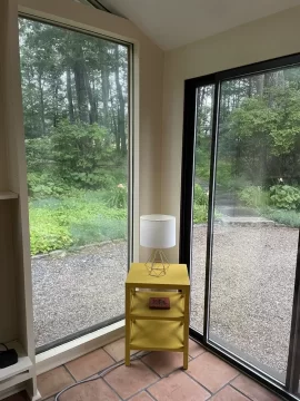

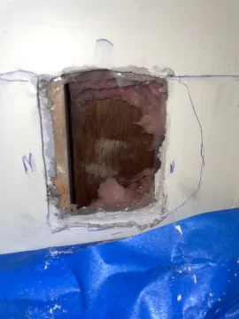

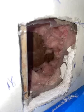

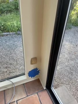

The trouble is that they recommended different ways of doing the install. One guy said we can easily go through the back wall, on the interior left side of the corner (exterior right), as there is a hair more than 5" between the 2x4 studs, and he thinks it will be fine for the pipe he has in mind. You can see that we already started opening the wall in the spot he has in mind. The other guy thought going through the back wall was a very bad idea, mentioned something about the exhaust being a square shape pipe that would not fit between the studs, and strongly recommended we needed to go vertical through the ceiling and roof.
Would love to get any opinions from the community on the best way to approach this, as it's our first stove and we want to get it right. Thanks in advance!

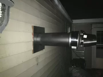

It is your choose
straight out would be the least expensive
Up and out would look nice (old-style wood stove look)
but the clean-out Tee would be inside some people don't like it there.
Or you can go straight up and out the roof but again Tee is in the house
Personly I like the old wood stove look
Just my nickels worth (Inflation)

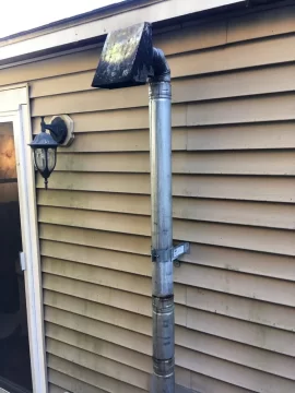

i see a few issues i see with this install.. Vent is to low and someone may get burnt by the exhaust, Snow build up may burry the exhaust, and from the pic's it really does not look like that space is big enough for the pipe may be a little hammer work to get it to fit. The other issue i see is heat and windows do not get along, I have seen windows explode due to the heat off the stove that's the last thing you want in the winter...
This one is from my own experience you never want to go strait out the back of the stove, All stoves are not the same and if you change the stove in the future the outlet probably will not line up.. Ask me how i know this one...LOL

Thanks for the replies so far. Good point about the vent being low. I was assuming that there would be a right angle piece outside which would extend the exhaust upwards. That would solve the snow and potential burn safety issues correct? Isn't the pipe that goes through the wall 4"? If so there is at least an extra 1" of clearance (even though it doesn't look like it in the photo because the hole was cut too far to the left). Regarding heat - was I under the false impression that pellet stoves only push heat forward? We knew the heat would be a problem for a wood stove here, but thought we'd be okay with a pellet for that reason.
Me. I prefer out the back with the the cleanout Tee outside and a vertical and vent cap on an elbow facing out. Don't see any issue with a hot vent shattering a window, not a wood stove so the venting won't get hot on the outside anyway but I would have waited to get the unit and went to Home Despot or Blowes and got some precast pavers to lift the unit up a bit first. I have mine up on a brick hearth pad with another course of pavers on top of that for added height.

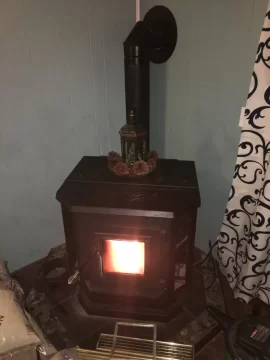

Only radiant heat off my stove is off the front glass
Sides and back are just warm to the touch
Yes i know where the majority of the radiant heat comes from on a pellet stove... Just passing on what happened with 2 people i know this year.. Everything has been fine for years and well this year bang... We figure the air flow in the home pushed some of the heat towards the window more than normal. hot and cold do not get along will with glass and it must just been enough to break them.. Could also have been the gas vacuum in the glass that let go so the inside window got as cold as the outside. 1 set of windows was fairly new and the other set old and of similar design to original post. Just passing on information as i know in both cases it was a real pain to get sealed off, keep the heat in, until the new windows arrived..
Personally speaking, I don't like the install place at all. In fact, I think it sucks big time. Too much glass too close and especially the skinny corner wall. I'd be putting the unit somewhere else if it was my install. Just my 2 cents.

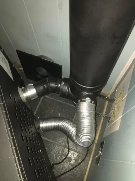

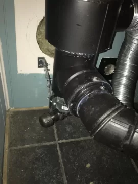

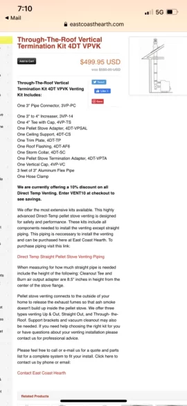

I would bring in the fresh air (outside air kit) thru the back wall and then shoot the dirty exhaust through the roof to keep the soot away from the windows and house!
It is not the cheapest way but the cleanest & most efficient way for sure!
I wouldn't because that puts the cleanout Tee inside the living space and that can and will be messy to clean out. I always put my cleanout Tee outside. My install is similar but I went with 4" venting above the clean out because I had to install 2 elbow's to clear the overhanging eave
The inside clean out is not messy at all with the Selkirk Vacuum Cleanout. That is what I use!!
Also only one hole for exhaust and fresh air. The fresh air gets dry and warmer from being around the hot exhaust and makes any stove 10% more efficient so your heating bill is 10% less. :)

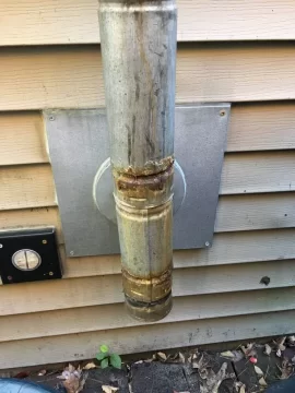

The old ugly venting went straight out and up with a cleanout outside and It rotted right out and made a big ash mess on the deck every time the stove was cleaned!!!

Whatever blows you dress up... I guess. 22 years with mine and the only part that finally corroded last year was the 3-4 cleanout Tee on the outside and I burn corn which is a lot more corrosive than pellets.... and that was the cleanout cap but I replaced the entire Tee for 60 bucks. $499 bucks sounds kind of steep too. I don't much care for the short sections. I like the 8 footers. Less joints to sweat.

If either of those windows open up I believe that might be a code issue if the pipe terminates at the outside wall and it isn't continued up and through the roof. Not sure there is enough clearance where the pipe goes through the wall.

Like I said before, I don't care for the location, code not withstanding.
The price is higher because of the 3 rd wall to bring in the fresh air into the burnpot that warms and drys the fresh air. It is well worth it because the ash stays so light and fluffy with no moisture content it makes the stove a breeze to keep clean. Also that round metal pipe cap unscrews and that is where you hook the vacuum up while you stick a brush down from the outside. Just so quick and easy to keep clean too!

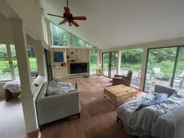

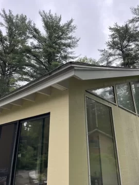

Big thanks to everyone who has chimed in so far. I understand your very valid concerns surrounding this install location, but this is really the only spot in the house that makes sense so I feel determined to make it work somehow. I plan on doing major efficiency upgrades to this house, but for the time being I need a solid backup heat solution for the mini splits we will be installing in a few weeks, and a pellet stove checks every box for us. This room gets super cold during the winter, and positioning the stove in the corner would heat the area where we spend most of our time, and would also pump air directly into the rest of the house.
I'm not disagreeing with anyone here, but I wonder if seeing it in person makes a difference. For what it's worth, the guy we have lined up to do that install is very highly regarded in the area, and he said he's designing us a custom thimble for the narrow wall passage, and a custom exhaust cap that alleviates snow concerns. He said we could go through the roof if we want, but it would cost more and that roof exhausts are prone to leaks. He seems confident that this install location will be fine.
Regarding the concerns about the the windows breaking due to the heat, we're looking into having custom interior storms made, or something like Indow interior window inserts. This would reduce heat loss and also act as a protective barrier. The window to the left of the yellow table does not open, but to the right is a sliding door that opens on the right side.
Attached is a wider view of the room. Install location is back right where the yellow side table is at the moment.

Sidecar - We are planning on doing something similar here, I think that makes a ton of sense. The reason there are so many windows here is because this house is on a gorgeous piece of property with Japanese gardens, meadows, and mountain views. Unfortunately the best views are to the West and North, while the Southern view is just a damp forrest and neighbors a few hundred yards away. This house gets a ton of ambient light but hardly any direct sun. So I'm thinking we'll replace the tall trees to the south with shorter species over time, allowing better solar clearance. Then we'll remove as many West and North facing windows as we can without compromising the views.
So even though this room is impractical and cold, it's a really wonderful place to spend time, and it would provide perfectly angled airflow to heat our entire first floor. It's the only spot that makes sense but if the overwhelming opinion here is that I'm begging for trouble then maybe I should ditch the pellet stove idea...
