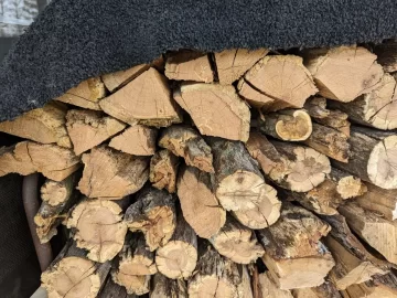

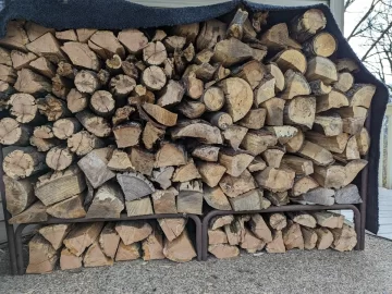

Sure, I could've gone with the conventional approach, just bring up the driest wood I have which is White Oak and BL that's been split five or seven years, don't recall. But I don't always go by the book; I've found that there's a pretty wide range of what can happen with this wood stuff. Plus I like to always have Cherry on hand to burn, if I feel like it. I thought this was all I had on hand, and it seemed to meter just a hair over 20%, so I gave it a shot. I don't think every split is sizzling, but that one in the pic was actually bubbling out for a while, so that got me wondering.
Turns out I did have other Cherry I coulda used, on the front of a Red Maple stack. Stacked for a couple summers. DOH! 😴

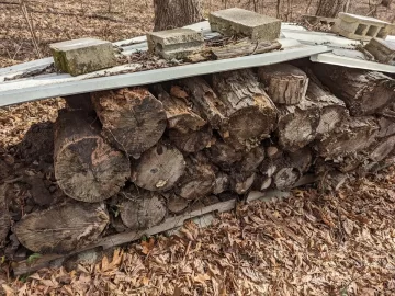

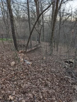

A lot of times, I cut rounds but then don't stack 'em right away if I've got something more pressing. Or I'll have a deadstanding Oak or whatever that I don't drop right away, I might wait for the sapwood to get crumbly so that it's easily removed.

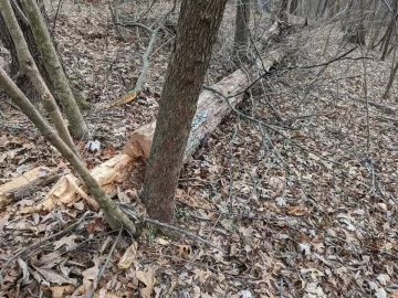

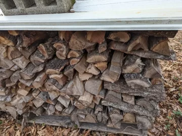

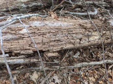

It depends, among other things, what specie it is regarding how fast it will dry in rounds. Red Oak could take many years in round form to dry, I haven't experimented with that much yet. I know that Red Oak is usually pretty wet inside.
Contrast to that, the dead Post Oak (a White type) that I've been aware of for years, at SIL1's house, and I was waiting for the sapwood to fall off. Tree (14") finally fell, but hung up. Bummer (danger.) But then it blew down in a big wind event last week...thank you! 😎 It fell on and bent over a couple saplings, and she urged me to come over and save them ASAP, which I done did do. The entire top that I cut felt pretty light for White Oak type, and metered at 16-18%. Giving back a couple points since it was upper-40s out, that's still easily burnable in her secondary stove so I put some on and below her porch stack. Anything above 20% (probably the remainder of the trunk) will be shedded, then tested next fall. Pretty confident it'll be good to go.

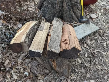

So with a day in the 40s, I rounded up some splits to jab; Right to left, two of the biggest Cherry from the same batch as the sizzler, a smaller BL also split in the fall, after sitting in rounds for at about seven years. And a Cherry from the new stash I found, fresh but split two years. Everything was 11- 17%. Adding 3 pts. for low outside temp, that's still all pretty dry... Shouldn't be sizzling I wouldn't think, unless it absorbed rain water.
The hard Maple rounds were also out there three summers, cut from a live but dying tree that was too close to the house. I split that a few months before the Cherry, and I think I was getting like 21 or 22%, and figured with several summer months more drying it would be pretty good. Now, it's true that as the moisture approaches the lowest point it will get to, drying the last couple percent takes longer. But a test split hard Maple also tested 16%. It's not in this pic.
