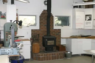

I have that stove in my shop. Single-wall stovepipe. Magnetic thermo stuck just above the flue collar. Routinely cruises around 400°F. Early in a burn it can approach 600°F. I don't sweat what the actual flue gas temp might be, or the temp inside the firebox, or on the stovetop. I don't care. I use the mag thermo on my stovepipe as my operating guide. I've learned what's normal.
