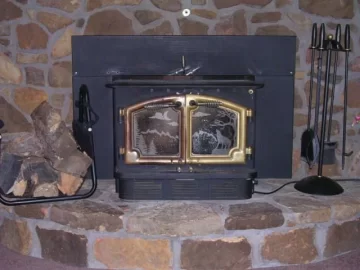

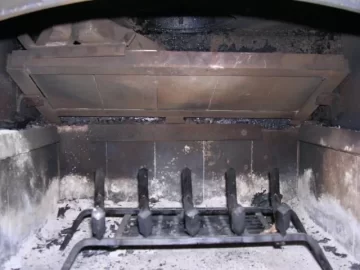

This is my first post to this excellent forum. I have large two large masonary fireplaces in my home and wish to obtain inserts for both but I'm on a tight budget. I am currently looking at an older lopi on craigslist which looks to be in good shape. The owner doesn't know the model number. I have attached two pictures. From my readings in this forum, I think it is a version of the Lopi 520 or LX possibly from the 1980's? Please help me ID this insert. Additionally, its previous installation was just slid into a masonary fireplace directly exhausting into the flue. I know this is not acceptable for current code. So, a critical question I have about this insert is whether or not I can use a stainless liner/block off with it? thanks in advance.

There is a baffle plate in it, but no secondary air tubes. There is a mystery hunk of something on the top left above the baffle plate? It wont be nearly as efficient as a modern insert, you will probably burn 1.5x to 2x more wood and get the same heat output as a modern unit.
It also seems to have the air control style on the top where you restrict the outgoing exhaust. I have seen others with this style on here before, I don't know how well it works.
Looks like it has a round flue outlet already. You should be able to use a 6" round liner on it. Some of the old units did not have a boot on the top to hook a liner to, but most liner manufacturers sell different sized boots you can drill and screw to the top of these style units.
The intake air is controlled by the two sliders under the front of the doors. The one on top is a flue damper. A problem with a lot of these older inserts is fitting a liner adapter to them because of obstruction from the flue damper. The rod keeps a "boot" from fitting flat on top of the insert.

If the Lopi is the way I think it is, yes you can cut the rod and the damper plate and take it out. But given the increase in draft with a liner on a unit that was designed to burn as a slammer I wouldn't want to chance it. You could end up with an uncontrollable stove.
When I installed a liner on my old insert the increase in draft was scary. But it was configured such that the damper didn't have to be removed.
I'd prefer to leave the stove intact and not touch the flue damper. Seems like the liner or appliance adapter could get a slim notch to fit around the damper handle rod, no?
