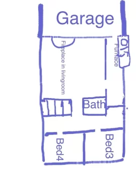

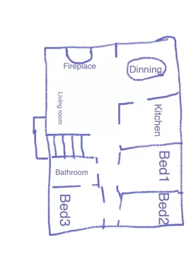

We live in a 1300 square feet raised bungalow with the same living space in the basement.
the basement has 2 bedrooms a bathroom and living room, so there is a lot of separation.
We have a chimney that is currently capped and have empty insert areas both on the main floor living room and basement living room which is exactly underneath each other.

Does anyone have any experience in connecting it to the forced air ducts

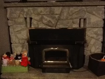

Pictures of the old fireplace would be beneficial.
[Hearth.com] Considering pellet heat Basement fireplace
I have not connected to the ductwork, but if you do so you need a pellet furnace, not a stove. The blower on a furnace is designed to move more air. There are several on here with pellet furnaces, but cost is higher and they require more room. Try searching for those threads, and you might want to research those on mfr websites. Pellet consumption will be higher as you're generating more BTUs.
What's wrong with the woodstove in the picture?
Nothing wrong with it,
The chimneys are sealed and have not been used.....
I don't want to deal with messy wood and bugs in the basement.
Why not unseal Chimney and burn compressed wood bricks?

Does your house layout have many separations, does it heat the house and bedrooms well?
