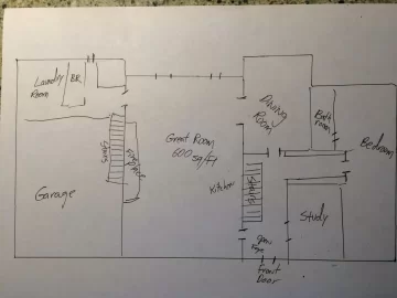

After talking with Woodstock I was a bit concerned that it is too big of a stove for our house. The room it is going in is 600 sq feet, A few feet from the fireplace, on the same wall, there is a door opening that has a small stairway to a great room above that. Then on the opposite wall from the fireplace there are two openings, one is about a 6 foot wide opening into a dining room and the other door is a standard door sized opening that has a big opening up to three bedrooms on the second floor. Here is my question. Will it be too big and make our main room too hot to operate? Or can you use less wood with this stove? Or can you use a full load, get it going and then crank it down? I know fans will help the situation as well.
To help even out the temps moving the heat may help. The best way to do this is to blow cooler air, say from the hallway, into the stove room. There are a few ways to do this. If you can post a sketch of the first floor plan showing the stove location then we may be able to make a more detailed assessment.

  • [Hearth.com] Considering Progress Hybrid in Brick Fireplace
It looks like you can get a decent convection loop established. Do you have a 10-12" table fan or a small box fan? The idea is to blow the cooler air down at floor level, toward the stove room. For more even heat in the house put the table or box fan in a cooler room within sight of the stove room, say in the dining room opening, placed on the floor, pointing toward the woodstove room. Run it on low speed. It will blow the cooler air down low, toward the woodstove. The denser cool air will be replaced with lighter warm air from the stove room. Running this way you should notice at least a 5F increase in the dining room and hallway temp after about 30 minutes running. And the stove room temp should drop by a corresponding 5+ degrees. A more sophisticated version would be to run a 6-8" insulated duct under the floor with an inline blower. The intake grille would be at the end of the bedroom hallway and the output grille in the stove room, near the fireplace. Panasonic makes good quite remote bath fans that work well for this application. About 150cfm will work fine.
