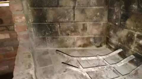

Also, the lip of my firebox comes up one brick from the inside. When installing the insert would it make sense to level the inside with more bricks or is there another way to handle this? Most of the installation diagrams/videos I've seen are installing it into a completely flat/open firebox so I haven't seen any ways of addressing this situation. I'd imagine if I install it the way the fireplace is now that the back will sag down.

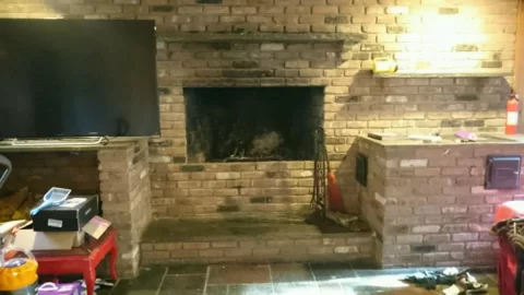

Here are the pictures I have. If any other pictures would be helpful please let me know.

Thanks for posting the pics of your fireplace. I see what you're talking about with the lip. You could fill it in with bricks, but you could also just put in a couple of large pavers that are the same height as the lip so that you have a level surface. Probably the biggest challenge that I see is that there will be no support for the front part of the firebox because your hearth is so much lower than your fireplace opening. In my opinion, it would not be safe to have it just hanging over the edge with no support underneath it. Then you'll need to ensure that you have 16" of hearth protection from the door outward from the stove. I'm guessing that since this is in the basement, it's just cement under the tile? If so, you should be all set in that regard. This time of year all the installers are usually swamped, so I'm not surprised that they are hesitant to come out without a commitment.

We've been trying to figure out what to do about the hearth. The floor is slate tile with cement underneath.

We were thinking of just building up the brick around the outside to give the stove something to sit on. I'd install an actual floating hearth but can't find much information on how to do that. All I can find is information on how to make a mantle.

Building up the brick on the outside would most likely be the easiest thing to do and look the most aesthetically pleasing.
