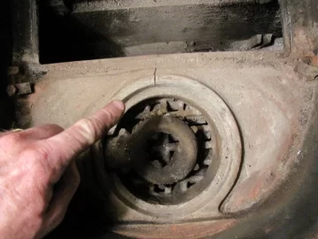

Figured I'd update on the stove and seek another bit of advice or opinion. The stove has performed well so far with only one area of concern. Towards the end of a fire, when it's getting down to a coal bed and little wood is left actually burning, sometimes the combustor temp probe jumps/spikes to 1650deg. There is a small crack in the baffle running from the damper to the combustor ring area. I filled this with gasket cement till I can tear it down next spring.
We've followed the op manual directions, getting an established fire with damper open, once combustor temp probe shows 500deg we close damper, once it gets to 800 we reduce primary air and she cooks right up to 1000-1200 for a few hours depending on wood load. We really haven't put more than two splits in and it seems the spike in temp happens even on one split. Manual calls for 2 turns on secondary (combustor) air vent and 2/3 turn on primary (firebox) vent with a medium/low fire setting. We've tried running this a little lower but are still getting a spike occasionally.
Any ideas on the reason this is happening? Any advice on how to avoid the spike or what to do when we see one? Is the crack in the baffle the culprit? If it is I would have thought the spike would have occurred in the first half of the fire. So far we've reduced the primary air and combustor air intakes when we see the temp spike, waited till it cooled a bit and carried on normally. Just concerned about damaging the combustor.

I don't run a catalyst probe, but I've never seen any obvious signs of a spike in catalyst temp late in the burn cycle. Maybe the coals are not done off-gassing, or there is another crack you're not aware of.. or the existing crack is causing a slight a blow-torch effect. Can't think of anything else.
