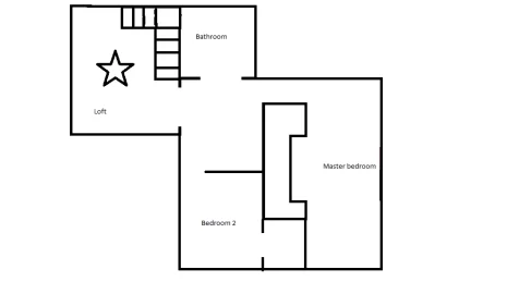

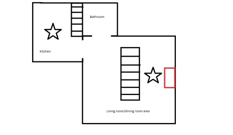

So I'm ready to rock and roll with the new stove installed and I was wondering what you fine folks thought I could do to get the convection flow goin! I've posted a terrible diagram of my downstairs and upstairs, complete with a red square for the pellet stove and stars to indicate where I currently have ceiling fans. I'm thinking if I run the ceiling fan in the stove room in reverse, plus the ceiling fan in the loft in reverse (furthest point from the stove) that I have a pretty good chance of getting a flow going. Since I have two sets of steps I think I have a pretty good setup for this. We normally keep Bedroom #2's door shut for the winter and have all radiators off in that area as well. Thoughts?

Try it. Sounds like a reasonable idea. You have a good open floor plan so I think you will be fine. If you have ac registers in the ceiling make sure they are shut so you aren't forcing warm air up there via the ceiling fans.

Get yourself something that produces a bit of smoke and you will soon find the natural air movements and work with them. Trying to work against the naturally occurring flow will only give you a headache wondering why your not getting the results your wanting. I simply twisted a paper towel and lit it and snuffed it to get a simple smoke.

I have a somewhat similar set up and I find if I run my stove on low it makes its own flow of heat(like its own little weather system) once its been on for a while. I use two thermostats one down stair and one upstairs and use the thermostat on the floor that I'm on, but the second one will call if the other floor gets to far from comfortable A wireless one would work just as well. If the first floor is 73 upstairs won't get much cooler than 69 or 70.
