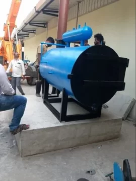

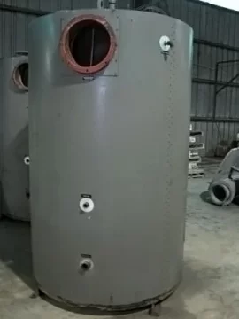

Here's a picture found online. Same brand FULTON 50-60 HP steam boiler. About 200 kg, 2nd picture is the horizontal position transformation; we are hoping to proceed with. As we plan to burn biomass (wood pallets, used carton boxes, dried coconut shelves). 5-8 bar needed @150-200 F steady flow. Cheers [Hearth.com] Conversion boiler to furnace[Hearth.com] Conversion boiler to furnace

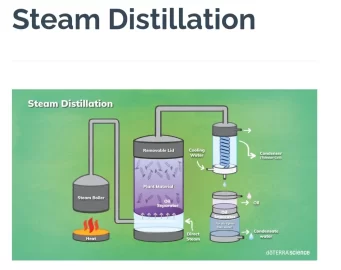

Beings how I know nothing about essential oil production I did a quick Google search. Is this close to what you are wanting to build?
  • [Hearth.com] Conversion boiler to furnace

I'm alittle confusion as to why it's necessary to convert the boiler from vertical to horizontal? Any steam created in the boiler will flow to where ever it's piped simply by pressure differential. What do you gain changing from vertical to horizontal?

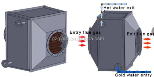

Here is the Heat economizer/heat exchanger for flu gas transfer. We will get for the transfer of gas from boiler converted furnace + by 2" boiler pipes transfer to Copper pot boiler 500 L/300 Gallon US. As to setting of horizontal Vs vertical. As opening will occur in furnace, easier to fill with used wood pallets; used carton boxes. Dried coconut shelves. We will need as well a 50 Gallon US water tank for feed to the furnace. As the mix of burning biomass/heat water @ 3-5 bar + 200 F to create needed Flue gas for transfer to distillation plant [Hearth.com] Conversion boiler to furnace
I just Google searched that boiler you mentioned. Everything I've found on it suggests it is a gas fired boiler. Is that correct? Are wanting to convert a gas fired boiler to biomass?
A.) we are modifying a 60 HP vertical salvage boiler to a horizontal Biomass furnace.
B.) we will be using the gas économiser in above picture for heat transfer. Flue gas from the furnace to Distillation copper pot boiler. To produce Essential oil.
C.) 3 bars/50 kg/h 107,000 BTU steady flow heat range.

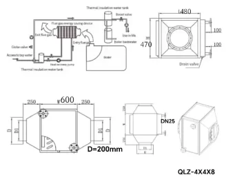

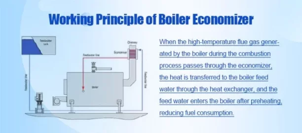

Guys, I thank you all. Solution found. This heat Economizer /heat exchanger. Will enable our Flue gas needs, from the burning of biomass furnace 60 kg horizontal. 3 bars/200 F/50 kg/H(107,000 BTU). I will use (2) two plastics water tanks (50 Gallon US)for in/out water supply. I will even use, the out water afterwards (as will be distilled water). For other products. Cheers to all :-)
